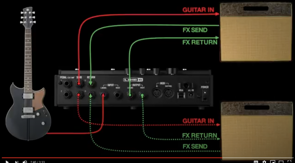

I know this original post was made back in 2011, but I found it while trying to resolve an issue I had concerning my Fender Blues Deluxe (FBD) Reissue Amp and thought I would post some info in case others have this problem in the furture.
I don't have ANY issues with using the POD HD500 with my Fender by using the following method:
Guitar into Input (1 or 2) of the Fender amp > Power Amp Out of the FBD into the Guitar In of the PHD500 and then 1/4" OUT L/Mono into the Fender's Power Amp IN
This allows you to use the FBD controls AND the footswitch that came with the amp as well as the controls of the PHD500.
I hope someone will find this helpful (if not, just ignore the man behing the curtain)
Re: HD 500 to PWR Amp: Volume?
by jimsreynolds on 2012-10-12 05:44:13.5980
That is a good and valid setup.  You have to bear in mind though that the Fender Pre-amp is now always in line with your setup .... effectively you are using the Pod as a stompbox in the amp loop.
The Fender pre-amp will always colour your tone before it gets to the pod.  If you are using FX Only, this is no issue at all when using  stuff like delays and reverbs on the POD and some modulations too.  Distortions and wahs may sound odd though.  Normally they go in front of an amp.
If, however, you are using amp modelling then you are always going to be hearing the Fender Pre-amp first.  This may not sound 'bad' but it may seriously limit how much you can modify the sound to sound like how you want it.
It's the usual deal .... the configuration isn't 'wrong' it just has some limitations.
